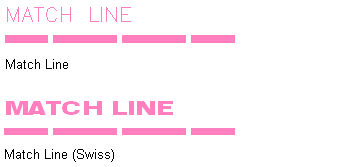

Match line annotations are used for annotating a drawing. Formerly available as content blocks in DesignCenter, these annotations are now available through tools on the tool palettes and in Content Browser.
Match line tools
By default, all match line tools are set to be annotative, which means that the annotations you insert with these tools are controlled by annotative scaling.
You can find match line tools in these locations in a default US install of AutoCAD Architecture 2021 toolset:
These properties of match line tools can be customized:
