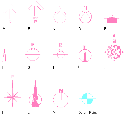

North arrow and datum point annotations are used for defining directions in a drawing. Formerly available as content blocks in DesignCenter, these annotations are now available through tools on the tool palettes and in Content Browser.
North arrow and datum point symbols
