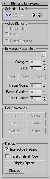

Controls for Envelope sub-objects are on the Blending Envelopes rollout.

Strength applies to both the inner and outer envelope bounds.
Used primarily for areas where envelopes overlap, and you want one to be more influential than the other.
Vertices within the inner bound are fully influenced (weight=1.0) and those beyond the outer bound get no influence from the link (weight=0.0). Falloff determines the rate at which the influence falls off from 1.0 to 0.0.
The Inner, Outer, and Both buttons determine whether the controls that follow, Radial Scale, Parent Overlap, and Child Overlap, apply to the envelope's inner bound, its outer bound, or both at once. First, use the buttons to choose which bounds to adjust, then change values in the spinners.
When Both is selected, the values displayed for Radial Scale and Parent and Child Overlap reflect the values for the inner bound.
A value of 0.0 causes the end of the envelope to fall on the joint. Values less than 0.0 bring the envelope inside the link, and values above 0.0 will overlap onto the adjoining link.
