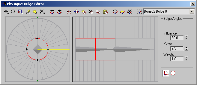

Cross Section view displays an outline of the active cross section. In Profile view, the active cross section is shown in a bright red color. In Cross Section view, you can edit cross sections to bulge the mesh.
These are the elements of the cross section display:
Represents the link at the center of the cross section.
When unselected, are shown as small black crosses on the control spline. When selected, they are shown as black squares with a white center.
Display as gray lines that surround the link radially. Control points snap to these lines as they are positioned.
You can increase or decrease the resolution by changing the Resolution setting. This control is on the Bulge rollout in Bulge Sub-Object. The Cross Section view, however, always displays 36 resolution lines.
The control spline for the active cross section.
The shape of the spline determines where mesh deformation occurs.
Represents actual mesh deformation. (Typically this is less exaggerated than the control spline.)
When you drag the time slider or play an animation, this updates according to the angle of the limb and the bulge angle parameters.
The bright yellow radius indicates the orientation of the “slice” shown in profile view. Profile view always shows a vertical profile of Cross Section view, indicated by the green dots at the top and bottom of the view, just outside the circle that contains the resolution lines. By default, the orientation bar is level at 3 o'clock. You can change the Profile view orientation by dragging the end of the orientation bar (the cursor changes to a miniature cross section). This lets you view different angles of the bulge in Profile view.
Use Profile view to select, move, and copy cross sections on the selected link and its child. Highlight a cross section in Profile view to display and edit it in Cross Section view.
Profile view is a schematic profile of two links. The currently selected link is on the left, and its child link is on the right. If the selected link is an end link, the outline of the right half of the Profile view turns gray.
Cross sections are shown as vertical bars across the profile. The active cross section is red. Unselected cross sections are white. Cross sections that are selected but not active are dark red.
You can use a rectangular selection region or Ctrl+click to select multiple cross sections. Although only one cross section at a time is active in Cross Section view, you can use the Cross Sections panel to change parameters for multiple cross sections.
Profile view shows a profile of the bulges you create. As in Cross Section view, the control spline is red and the deformation spline is green.
The profile is always a vertical profile of the Cross Section view. You can drag the orientation bar in Cross Section view to change the angle of the profile.
To insert a new cross section, turn on Create CS Slice and then click Profile view to set the cross section's location.
You can use the Draw tool in Profile view to change the control spline by freehand drawing. Drawing updates the cross section shapes.
At the right of the Bulge Editor are two panels for setting parameters. Use the Bulge Angles panel to change bulge settings for the active bulge angle.
Click to display the Bulge Angles panel.
The range of angles through which the bulge influences the skin. Range=0 to 180. Default=90 degrees.
For example, if you’ve set a bulge angle for the joint at 90 degrees, an Influence value of 40 means that the bulge effect begins to appear when the rotating joint reaches 50 degrees (90 minus 40) or 130 degrees (90 plus 40).
Controls how smoothly or abruptly the bulge takes effect.
At 0, the bulge takes effect immediately, without interpolated easing. As values increase, the bulge eases in gradually. A value of 10 will bulge the mesh abruptly when the set angle is reached. Range=0 to 10. Default=2.5.
Increases the effect of the current bulge angle relative to the effect of any other bulges. Range=0.0 to 100.0. Default=1.0.
