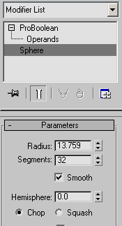

With an unmodified ProBoolean object selected, the modifier stack shows a single, expandable entry: ProBoolean.
Expanding this entry (by clicking the + icon) reveals a single subsidiary branch: Operands.
To transform operands in the ProBoolean object independent of the entire object, click the Operands branch to highlight it.
You can then select one or more operands, either by using standard selection methods in the viewport, or by highlighting their names in the hierarchy view list at the bottom of the Parameters rollout.
When one, and only one, operand is selected, the object type (not its name) appears as a separate stack entry below the ProBoolean entry. Clicking this entry provides direct access to the operand's parameters on the Modify panel.

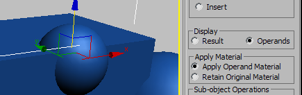

If Parameters rollout
Display is set to Result, selecting an operand displays the operand's axis tripod or transform gizmo in the viewport, although the operand itself is not visible by default.
To view the operand, set Parameters rollout
Display to Operands.
Whether or not the operands are visible, you can transform and animate them at the Operands sub-object level, as with any other object in 3ds Max.

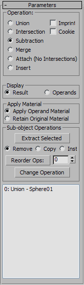

Choose a radio button to specify how the next operand you pick is transferred to the Boolean object:

Choose one of the following display modes:
Choosing Result also activates the ProBoolean level in the Modifier stack.
Choosing Operands also activates the Operands level in the Modifier stack.
Also, when picking many operands, use this mode to avoid having to recalculate the result each time, and then set Display back to Result at the end.
Choose one of the following material application modes:
These functions operate on operands highlighted in the hierarchy view list (see following).
The hierarchy view, found at the bottom of the Parameters rollout, displays a list of all of the Boolean operations that define the selected mesh. Each time you perform a new Boolean operation, 3ds Max adds an entry to the list.
You can highlight operands for modification by clicking them in the hierarchy view list. To highlight multiple contiguous items in the list, click the first, and then Shift+click the last. To highlight multiple non-contiguous entries, use Ctrl+click. To remove highlighting from a list entry, Alt+click the highlighted item.
At the ProBoolean level in the modifier stack, you can perform only sub-object operations on highlighted items. At the Operands sub-object level, you can transform highlighted operands as well as perform sub-object operations; see Modifier Stack for details.

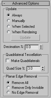

These options determine when updates are performed on the Boolean object after you make changes. Choose one of the following:
1. Decimation %=0.0
2. Decimation %=30.0
3. Decimation %=60.0
4. Decimation %=80.0
These options enable quadrilateral tessellation of the Boolean object. This makes the object suitable for editing subdivision surfaces and for smoothing meshes. It also makes the object suitable for conversion to Editable Poly format.
For further discussion of this option, see the topic Quad Meshing and Smoothing.
This option determines how the polygons on planar faces are handled. Choose one of the following:
