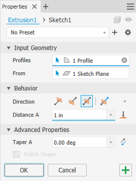

- At the top of the property panel is the breadcrumb. To the right of the breadcrumb is the
feature type. The type determines the options presented in the property panel.
- Specify the
Input Geometry. You can use window select to quickly select multiple closed profiles within the same sketch.
Note: Use the
From and
To options to get the same result as the
Distance from Face and
Between methods used in prior releases.
Important: During feature preview visible sketch dimensions can be edited without entering the sketch environment.
- Profile(s) - the Profiles selector is active by default and when there are:

- From - As the default, the extrusion starts from the sketch plane. To change the selection, in the From field, click the 'x' to clear the selection and choose a different starting plane. Work planes, sketch planes, and planar faces are valid input.

- Specify the
Behavior parameters, first choosing from the available options:
Direction: Default - Extrudes in one direction only. The extrusion end face is parallel to the sketch plane.
Flipped Direction - Extrudes in the direction opposite of Direction.
Symmetric - Extrudes in opposite directions from the sketch plane, using half the specified Distance A value in each direction.
Asymmetric - Extrudes in opposite directions from the sketch plane using two values, Distance A and Distance B. Enter a value for each distance. Click
to invert the extrude direction using the specified values.
- Distance A - specifies the depth of extrusion between start and end planes. For a base feature, shows negative or positive distance of extruded profile or entered value. Dragging the manipulator will modify the value.
- Distance B - specifies the depth in the secondary direction. Displays when Asymmetric is selected.
Through All - extrudes the profile through all features and sketches in the specified direction. Dragging the edge of the profile flips the extrusion to either side of the sketch plane. The Join operation is not available.

- In the
Output section specify the Boolean operation, choosing from:

- In the Advanced Properties section you can specify additional options.
- Taper A - sets a taper angle from 0 to 180 degrees normal to the sketch plane. The taper extends equally in both directions.
