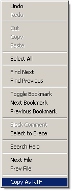

This is the default context menu which appears when you right-click in the Editor window:

Let's add this command with label "Copy As RTF" to the context menu by adding to the user.context.menudefinition in the MXS_Editor.properties file. The final definition looks like this:
user.context.menu=\ Next File |IDM_PREVFILE|\ Prev File|IDM_NEXTFILE|\ | |\ Copy As RTF|IDM_COPYASRTF|
Press CTRL+S to save the MXS_Editor.properties file.
Open a MAXScript file and select some lines.
Right-click in the Editor- the new separator and new menu item should appear!
Select the item "Copy As RTF" to copy the selected text to the clipboard including all formatting.
