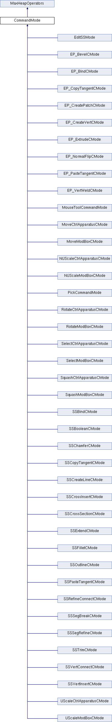

 Inheritance diagram for CommandMode:
 Inheritance diagram for CommandMode:| Public Member Functions | |
