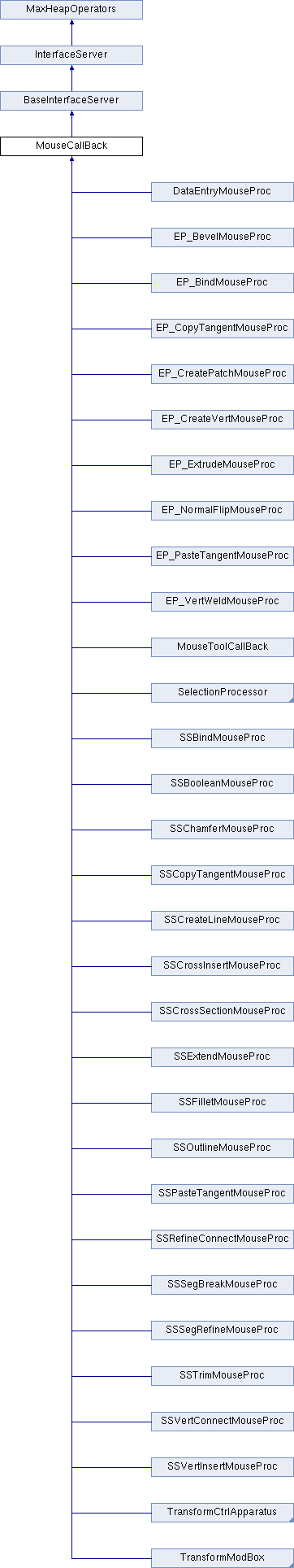

#include <mouseman.h>
Allows the developer to capture and process the mouse events entered by the user.
To create a mouse call back, derive a sub class of this class and implement the proc() function.
