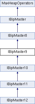

#include <Biped9Api.h>
Interface into the biped master controller for Max 9.
This contains functions supporting new biped features in Max 9, in particularly new functionality for setting large number of keys onto a biped at once, e.g. by loadin an XAF file.
