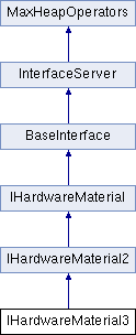

Extension of IHardwareMaterial2 Interface.
This class extends the functionality of IHardwareMaterial2. To acquire this interface, simply call GetInterface(IHARDWARE_MATERIAL3_INTERFACE_ID). If failed, it will return NULL.
