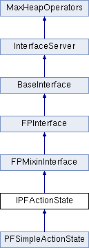

 Inheritance diagram for IPFActionState:
 Inheritance diagram for IPFActionState:| Public Types | |
