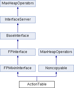

A table of action items that can be used by plug-ins to export tables of action items that can be used by the UI to attach to keyboard shortcuts, assigned to toolbar buttons, and add to menus.
3ds Max's core code exports several ActionTables for built-in operations in 3ds Max. Plug-ins can also export their own action tables via methods available in ClassDesc.
Every ActionTable also has an ActionContextId associated with it. This ActionContextId can be shared with other tables. When assigning keyboard shortcuts to items in an ActionTable, tables that share a unique context id are forced to have unique shortcuts. Tables with different context ids can have overlapping keyboard shortcut assignments.
All methods of this class are implemented by the system. Note that this class may be sub-classed if required and that many functions can be overridden. See the topic Action System for details on sub-classing this class and ActionItem. For details on implementing an ActionTable please refer to the sample at /maxsdk/samples/modifiers/ffd.
- Version
- 4.0
- See also
- Class FPMixinInterface, Class ClassDesc, Structure ActionDescription, Class ActionItem, Class ActionCallback, Class ActionContext, Class IActionManager, Class DynamicMenu, Class DynamicMenuCallback, Class Interface.
