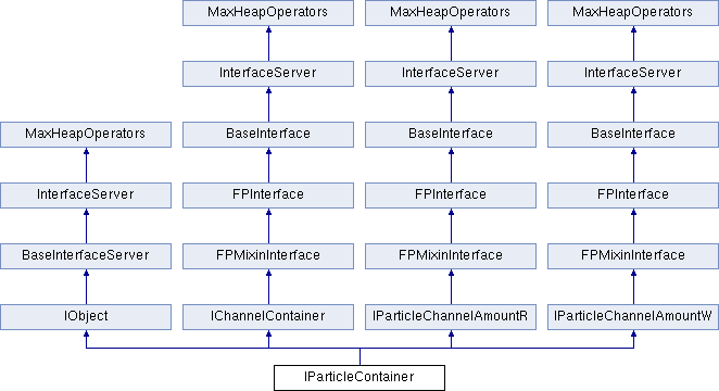

#include <IParticleContainer.h>
 Inheritance diagram for IParticleContainer:
 Inheritance diagram for IParticleContainer:| Additional Inherited Members | |
