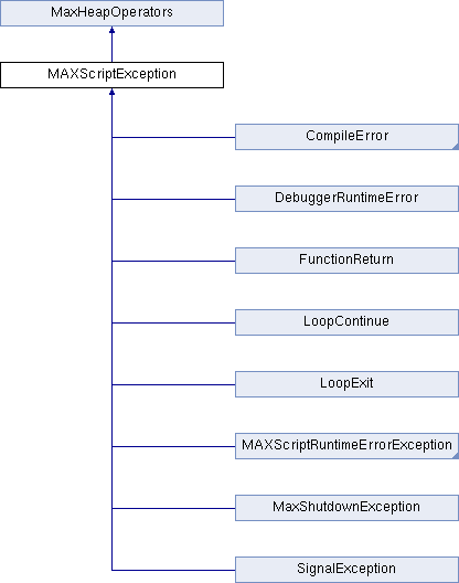

MAXScriptException Class Reference
#include <exceptions.h>
+ Inheritance diagram for MAXScriptException:
