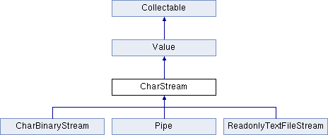

CharStream Class Reference
#include <CharStream.h>
+ Inheritance diagram for CharStream:
