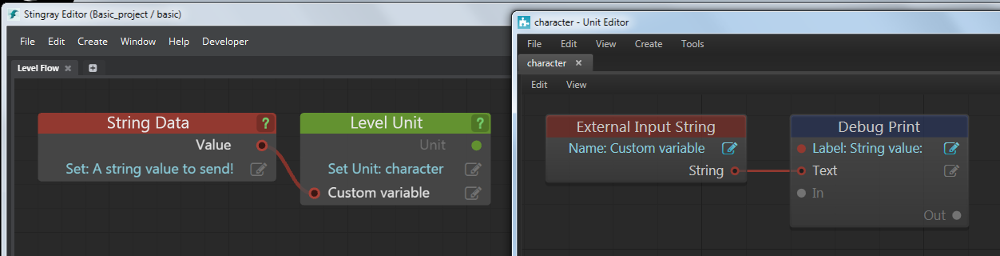

For example, the following image shows a Unit Flow graph that contains an External Input String node named Custom variable. When a Data > Level Unit
node for this unit is used in a Level Flow graph, it automatically offers an input connection with the same name, that accepts string values.
When the Unit Flow graph tries to read that external string value, it gets whatever value the Level Flow graph last passed in to that string
input connection -- in this case, the text "A string value!".
