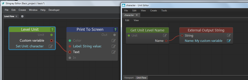

For example, the following image shows a Unit Flow that contains an External Output String node named Custom variable. When a Data > Level Unit
node for this unit is included in a Level Flow graph, it automatically offers an output connection with the same name. When the Level Flow graph reads
the value from this output connection, it gets whatever value the unit Flow graph last passed in to the External Output String node -- in this case,
the string produced by the Get Unit Level Name node.
