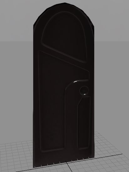

Dynamic TagVolumes allow to dynamically tag the NavMesh at runtime. A typical example is to tag the NavMesh while fire and smoke are propagating; in the tag, the navmesh layer can allow firemen to navigate in smoke while other bots can not. Another application is to tag the NavMesh with a smartobject to jump over fences that can be moved at runtime.
Dynamic TagVolumes can be added through:
See GwNavTagVolume in the API documentation.
The following script data setup the tagging (similarly to what is put in a GwNavGenTag, see "Tagging the NavMesh at generation time" under Generate the navigation mesh):
Add a box tagvolume to a Unit, adding a scriptdata object GwNavTagBox. The following children script data control the height, width and depth of the box:
place its local center: * GwNavTagBox/offset/x * GwNavTagBox/offset/y * GwNavTagBox/offset/z
and finally specifies the tagging by adding children script data to GwNavTagBox as described under NavMesh tagging script data above.

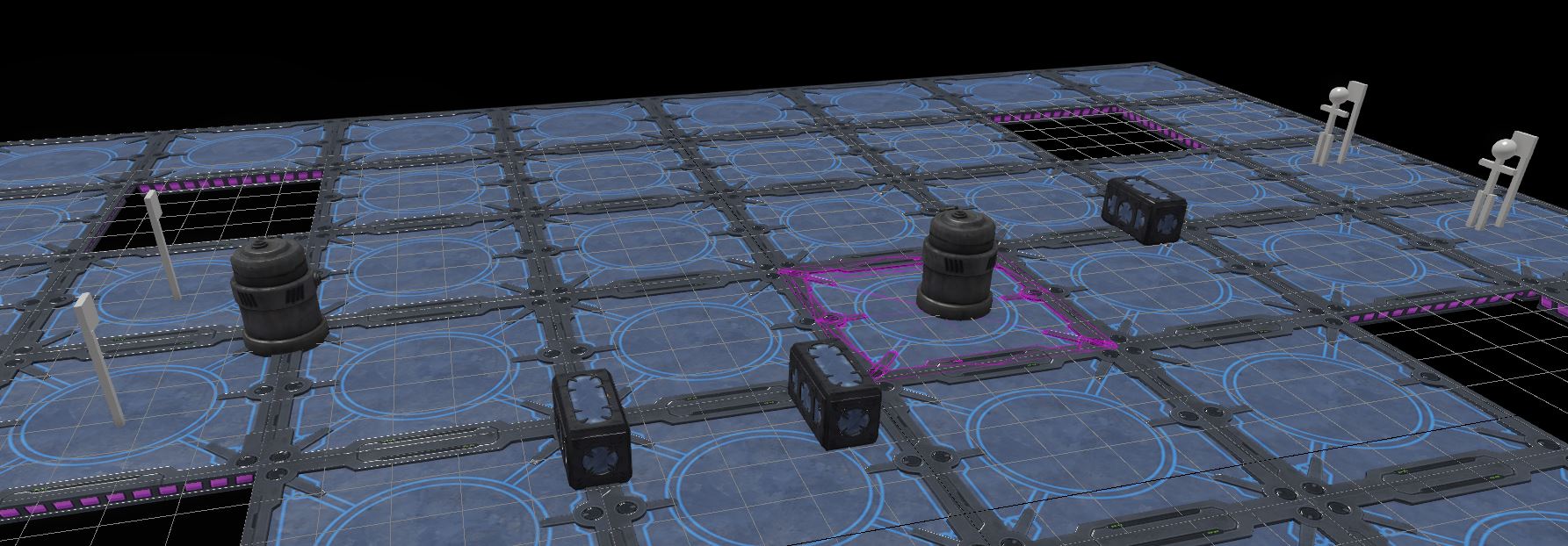

Obstacles are navigation objects which can be either taken into consideration by the avoidance system (for example when moving) or projected into the NavMesh as a tagvolume (when not moving).
Add a box obstacle to a unit, adding a scriptdata object GwNavBoxObstacle.
Height, width, depth and local center of the box can be set similarly to a TagVolume, see Specifying the TagVolume for a Unit. But it has two other parameters:
Set GwNavBoxObstacle/rotation_mode to free if the obstacle can freely rotate around any axis. like for example a physics obstacle. Set it to yaw (default) for obstacles mostly rotating around yaw like vehicles.
To make the obstacle trigger a tagvolume set the scriptdata GwNavBoxObstacle/does_trigger_tag_volume to true. If set to false, the obstacle will be taken into account only by the avoidance system. This can then be changed with NavBoxObstacle:set_does_trigger_tagvolume lua function.
Finally, specifiy the tagging by adding children script data to GwNavBoxObstacle as described under NavMesh tagging script data above.

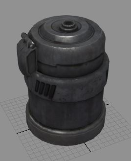

Add a cylinder obstacle to a unit, adding a scriptdata object GwNavCylinderObstacle.
The following children script data control the height and radius of the cylinder (the unit root position is the base of the cylinder):
To make the obstacle trigger a tagvolume set the scriptdata GwNavCylinderObstacle/does_trigger_tag_volume to true. If set to false, the obstacle will be taken into account only by the avoidance system.
