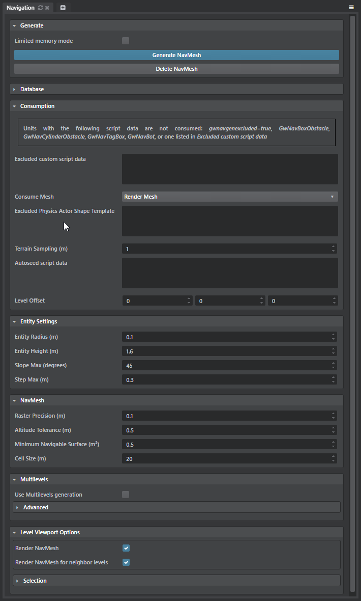

Configure input in the Navigation options.
Refer also to the complete Gameware Navigation documentation for details.

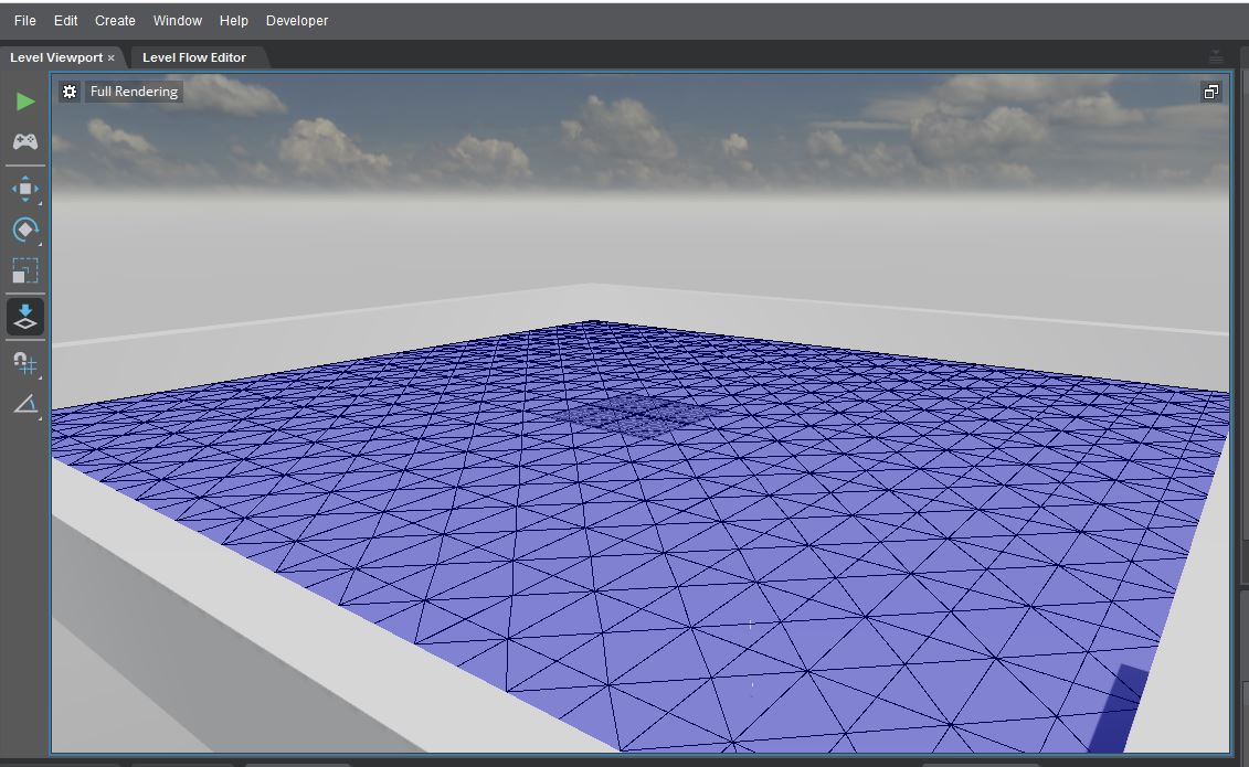

Click Generate NavMesh in the Navigation options to generate NavData.
Once generated, the NavMesh is rendered on top of the consumed Level geometry.
Tip: If you don't want the NavMesh rendered, turn off the Render NavMesh in the Navigation Options window.

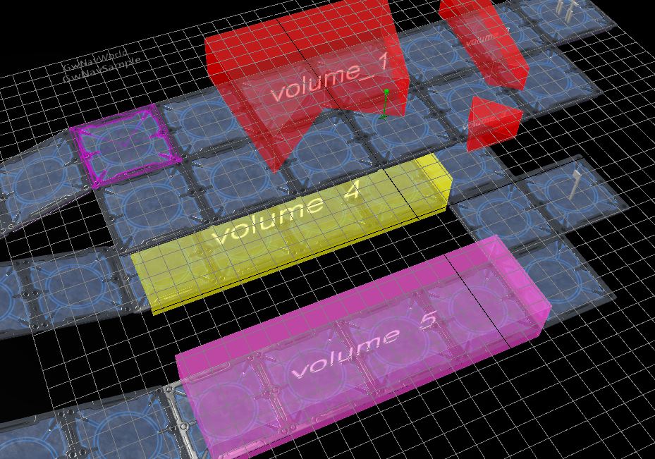

The NavMesh can be tagged at generation time either on a per-unit base or using the level editor's volumes with provided volume types.
To tag a Unit add a script data object GwNavGenTag with the following children:
The gwnav volume types are located in core/gwnav/volumes.

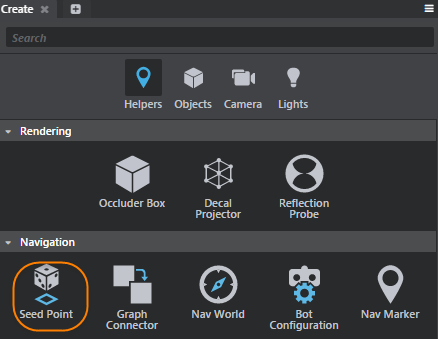

Spawn seedpoint Unit instances to only keep NavData connected to these seedpoints. This allows to prevent having NavData on tree tops, barriers or roof tops.
Also note that NavMarker unit can also be used as gwnavseedpoint script data -- this unit marks destination places, so you will likely want there to be a NavMesh in the surrounding area. However, the gwnavseedpoint property is unchecked by default for NavMarkers.
Seedpoints are accessible using the Create panel:

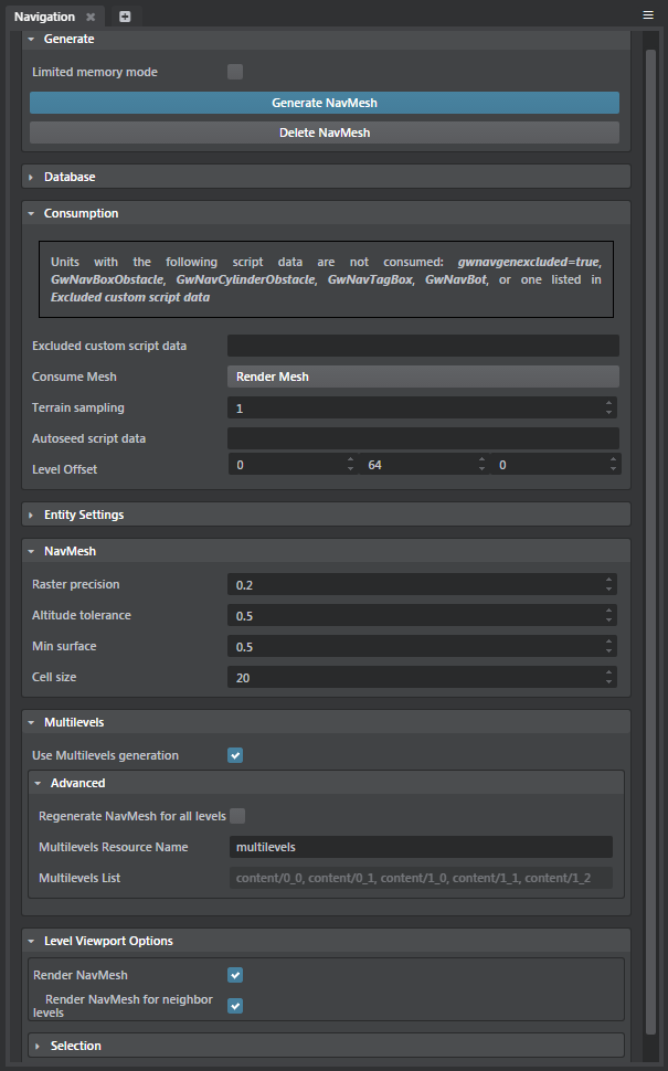

Multilevels Generation is useful if you have several levels loaded at the same time at runtime and you want your Bots to be able to move seamlessly from one level to another level. Each level needs a NavMesh generated at its runtime location, and each level must be generated with the same settings.
To set up, enable, and generate multilevel NavMeshes, create multilevels.gwnavgen_firstinit file. This file is used to intialize the multilevels NavMesh generation. Each level listed will have its generation settings aligned with the first level generated with 'Use multilevels' checked, and their offset set as specified. The offset must be the one corresponding at runtime. This file is optional; it is also possible to setup the multilevels directly in the Navigation panel of the editor, by checking 'Use multilevels' for each level implied in the multilevels generation.
Create a valid sjson file called multilevels.gwnavgen_firstinit with the following format.
initial_levels_offset_list = {
default = {
level_resource_name_1 = [0,0,0]
level_resource_name_2 = [10,0,0]
}In the Navigation options (Window > Navigation), enable Use Multilevels generation.
Click Generate.
A multilevels.gwnavgen_settings file will be created to share and sync the gwnavgen_settings files of level listed in multilevels.gwnavgen_firstinit.
Level offset can be modified in the Navigation panel.
Note: All the levels involved in the multilevels generation are displayed in the Multilevels List.
Tip: In order to iteratively generate Multilevel NavMeshes, it’s a good idea to back up .GenIO, and .ClientInput files in the project_gwnav folder to your source control (in addition to the project folder).
