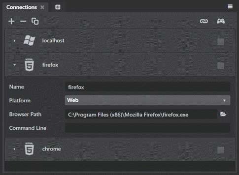

To launch your project in a browser from the interactive editor, you'll use the Connections panel to set up a new web target for each browser you want to use. (See also Using the Connections panel.)
In the Connections panel (Window > Deploy and Connect > Connections), specify a name to identify the connection.
Set the Platform option to Web.
The Browser Path points to the .exe file for your default web browser. If it's not a supported web browser (see the list above), you'll need to browse your file system to select the .exe of the supported web browser you want to use.
Leave the Command Line blank. For web connections, this defines extra parameters that are sent to the launched HTML page in the URL search string. These command-line parameters will be passed to the URL as GET parameters, which are then read by the engine and honored just like any platforms. If you want to customize the HTML page, enter the parameters here. Note that parameters that won’t make sense in the context of a web page might not yield the intended results.

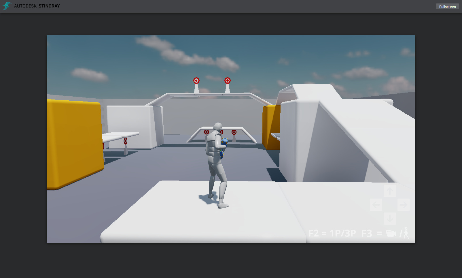

When you get the project successfully running in the browser, it looks something like this:

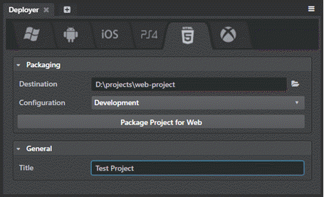

To deploy your project to disk (to get it ready for hosting on a web server), you'll use the Deployer panel. Go to the tab with the HTML5 icon, set up the requested fields, and click Package Project for Web.
See also Using the Deployer panel.
