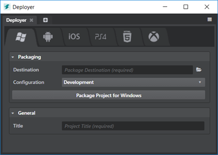

You can use the Deployer panel to create final, standalone packages of your interactive app on each of your target platforms. It has a separate tab dedicated to each target that 3ds Max Interactive supports.
Basic usage is the same across all target platforms:
Ensure that you have set up any prerequisites required for your target platform. See the page for your target platform under Supported platforms.
You provide the settings requested by the Deployer panel.
Click the Package Project for... button to launch the deploying process. The Deployer creates the final app package in the location that you specify.

There are some common fields that are shared across all tabs:
Specifies where to install the final package once it's produced. Within this destination folder, the deployer creates a sub-folder with the platform name. Within the platform folder, it creates another sub-folder with the configuration name. This means that all of your tabs can use the same destination folder setting without overwriting each others' output.
Make sure that you have write permissions to this folder, and that it does not contain any locked or read-only files.
