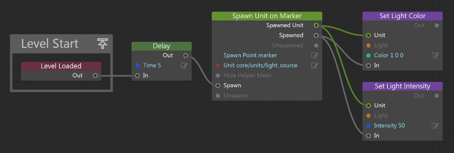

For example, the following chain creates a bright red light at a preset location after a short delay:
