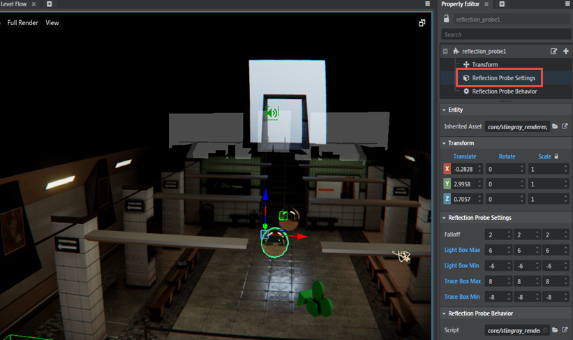

Click the viewport to place a new reflection probe into your level. Your probe is represented by a shiny sphere, giving you an idea of what objects it will pick up when you bake its reflections. Switch to the Move tool and adjust the probe's placement if needed.
With the probe selected, set the Reflection Probe Settings properties in the Property Editor:
The Light Box Min and Light Box Max settings control where in the level the reflections are shown when the level is rendered in the engine. Only surfaces inside this volume will be lit by the reflections baked for this probe.
The Falloff controls how far from the outside of this volume the reflections start to fade out. Lower values cause the reflections to stop over a smaller distance, as they would at the edge of a mirror frame. Larger values cause the reflections to fade out over a larger distance, which is typically smoother if you want to have multiple overlapping light probes.
The falloff is always linear over the distance set in the Falloff control. So, for example, if the light volume is set to [-10,-10,-10],[10,10,10], and the falloff is set to 2,2,2, everything between [-8,-8,-8],[8,8,8] will show the reflections from this probe at full intensity. At a distance of 8 meters from the probe location on each axis, the reflections will begin to fade out. They will fade linearly over the next 2 meters on each axis, reaching zero contribution at the outer bounds of the light volume.
The Trace Box Min and Trace Box Max settings control the parallax correction box. Set the dimensions of this box on all sides to roughly match the distance between the probe and the things it is reflecting. See Parallax correction below.

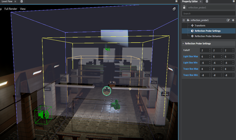

You can also use the reflection probe gizmo to set these box extents visually in the viewport. To do so:
Click the Reflection Probe Settings in the Property Editor.
This activates the probe gizmo.
Left click and drag the box to adjust the box extents. The orange box bounds correspond to the Falloff settings, the yellow bounds to the Light Box settings and the blue bounds to the Trace Box settings. Note that you can’t manipulate the Falloff settings (the orange box) in the level viewport. As you manipulate the bounds, the values are reflected in the Property Editor.
Place the cursor on any of the back faces of the probe box, Ctrl + left click to select the face and drag to adjust its bounds.
Right click to exit from editing the box bounds using the gizmo.

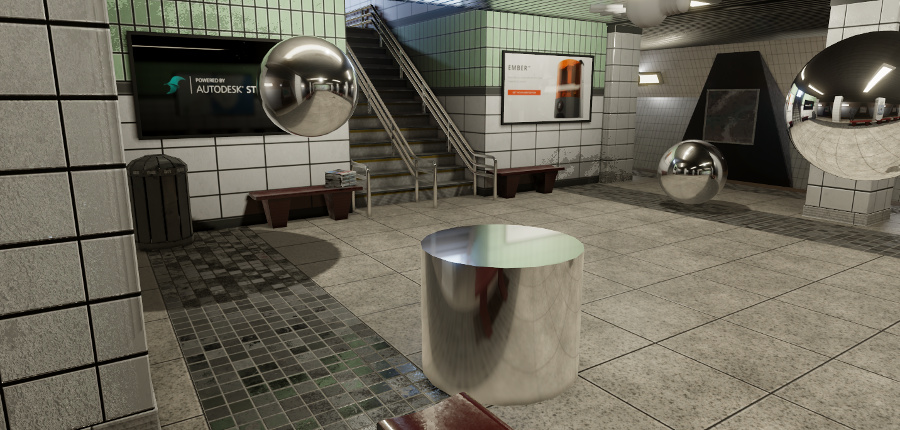

For example, this image has a single reflection probe (the sphere on the far right), with its parallax volume is set to closely match the location of the walls, floor and ceiling. Note that the reflections in the other mirrored objects remain relatively plausible, even when they are not very close to the location of the probe.
