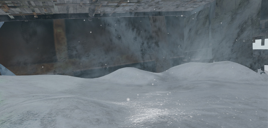

For example, in this scene, a global specular map provides highlights for the highly reflective icy ground.

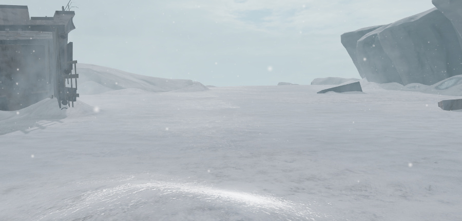

The fact that this global light map applies everywhere is also the downside of this approach: often the volume map will provide an inappropriate color or level of specular light for a given place in a level. For example, if the sky is visible to the light probe that baked the global specular map, that sky will be visible in reflections even when the sky would be occluded from the surface -- surfaces that are inside buildings or under other objects. In this image, the ice shouldn't be reflecting the sky, since at this angle the sky should be occluded by the walls and ceiling:

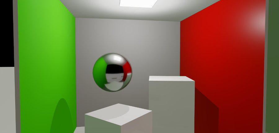

For example, in this image, a probe is placed at the location of the sphere. Its baked reflections override the global specular map, to provide an accurate view of the scene from the point of view of the sphere.

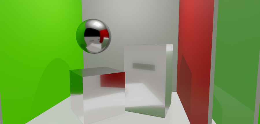

For example, in this image the boxes have been made very metallic, so they pick up the specular reflections baked by the probe. In this case, the reflections do not hold up: the taller box should be reflecting the red wall.

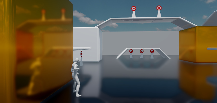

Here you can see not only the static targets and ramps being reflected, but also the dynamic character:

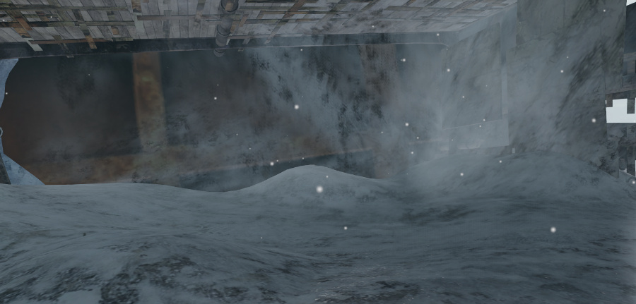

Screen space reflections complement baked probes by adding in dynamically moving objects, and by making surfaces more accurately reflect their surroundings. They can also complement baked probes by brightening or darkening the specular highlights according to what is actually visible. For example, in this version of the image shown above, the screen space reflections dim the impossible specular highlights on the ground:
