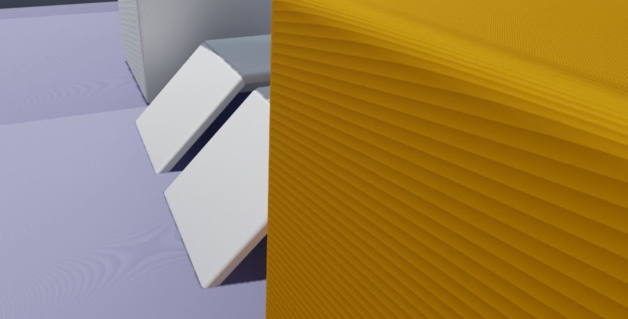

Each light has a configurable Shadow Bias setting, which offsets the shadow map by a small distance when applying it to the scene. Adjusting this value can help correct some common artifacts that can occur with shadow maps.
Increasing this value may help if you see flickering, banding (like on the orange cube) or "shadow acne" (moiré patterns like the ones on the floor):

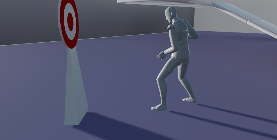

Decreasing this value may help if you see "peter pan" artifacts, where the shadows of your objects appear offset or disconnected from the bases of the objects. This makes the objects appear as if they are floating above the surface.
