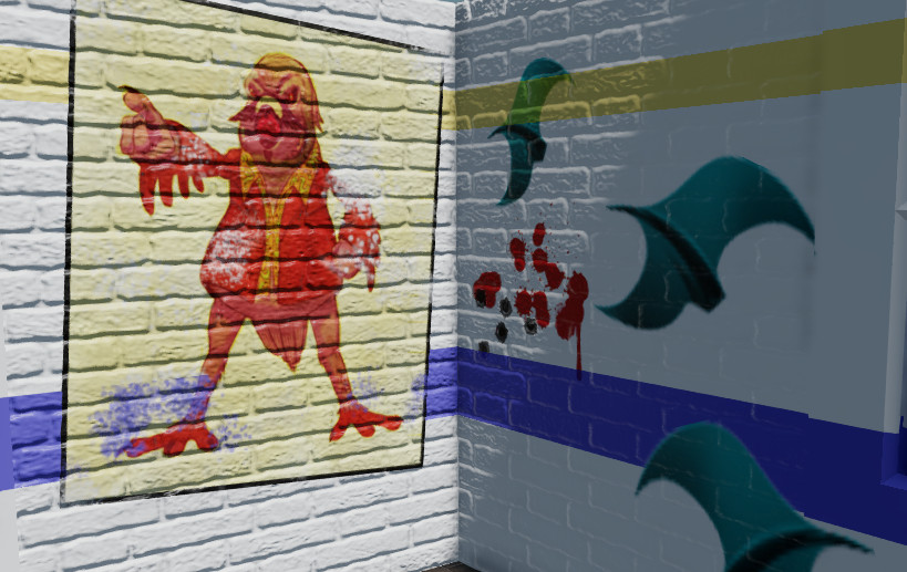

The image above shows a plain white wall enhanced in the level by several decals: a normal map for the brick texture, two semi-transparent color fills, color textures with alpha transparencies, and bullet marks that add both color and normal information.

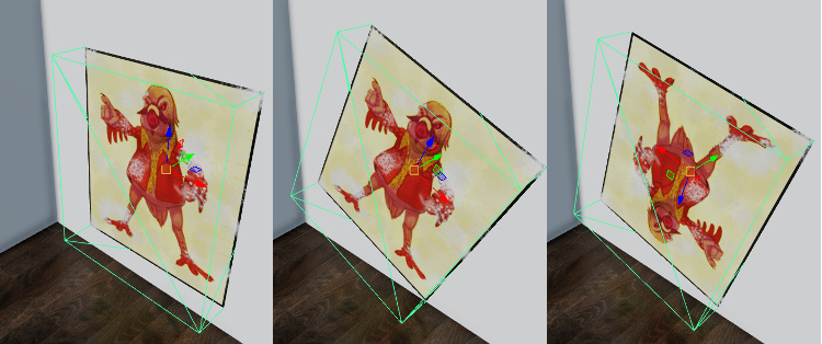

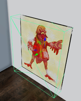

The texture is always projected orthogonally along the local forward axis of the projector box (the green arrow in the gizmo below), with the top of the texture aligned in the direction of the local up axis of the projector box (the blue arrow). By rotating the projector around its forward axis, you can turn the projection sideways or upside down.
The texture is also projected along the negative direction of the forward axis, but flipped horizontally. You can reverse your texture by turning the projector to face away from the intersecting mesh.

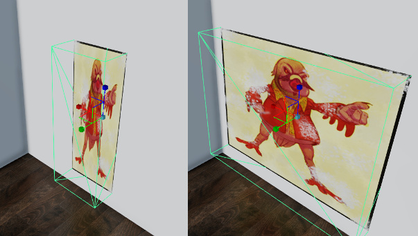

The projected texture is scaled to fit the dimensions of the projector unit along its local right and up axes. By manipulating the scale of the projector box along these axes, you can change the ratio between the width and height of the texture being projected.

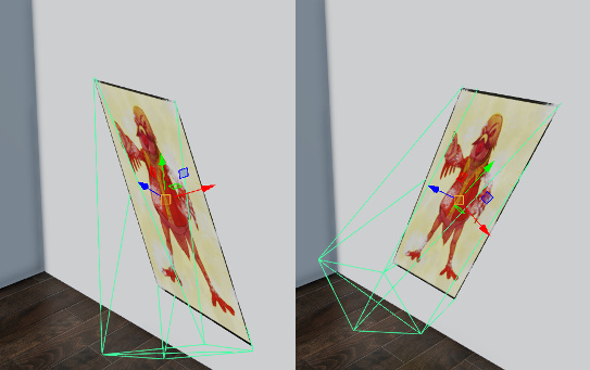

By rotating the projector to change the angle of incidence between it and the meshes it is projecting on, you can control the "skew" of the projection.

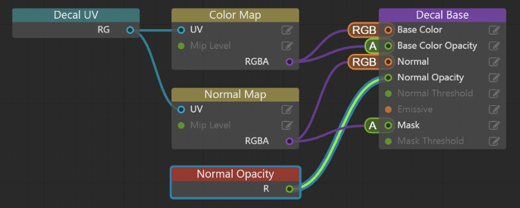

This opens the Shader Graph Editor with your material's graph loaded. You can re-wire the material nodes as needed. For example, the following graph adds the ability to set a normal map and map opacity for the material through the Property Editor. The alpha channel from the normal map is passed into the Mask input of the Decal Base node in order to prevent flat areas from conflicting withm surface normals added by other decals.
