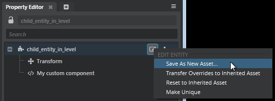

To create a new entity asset from an existing entity:
Select the entity you want to save as a new asset, either in the Asset Browser or the Explorer panel.
In the tree view of the Property Editor, click the
icon and choose Save As New Asset... from the contextual menu.
Use the window provided to set the folder location and file name for the new .entity resource.

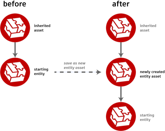

When you create an entity asset from an existing entity definition, all of the components and properties of the entity you started with are saved to the new entity asset. This includes its inherited asset, if any, and its record of modified components and settings. In addition, the entity you started with is automatically set to inherit from the new entity asset:
