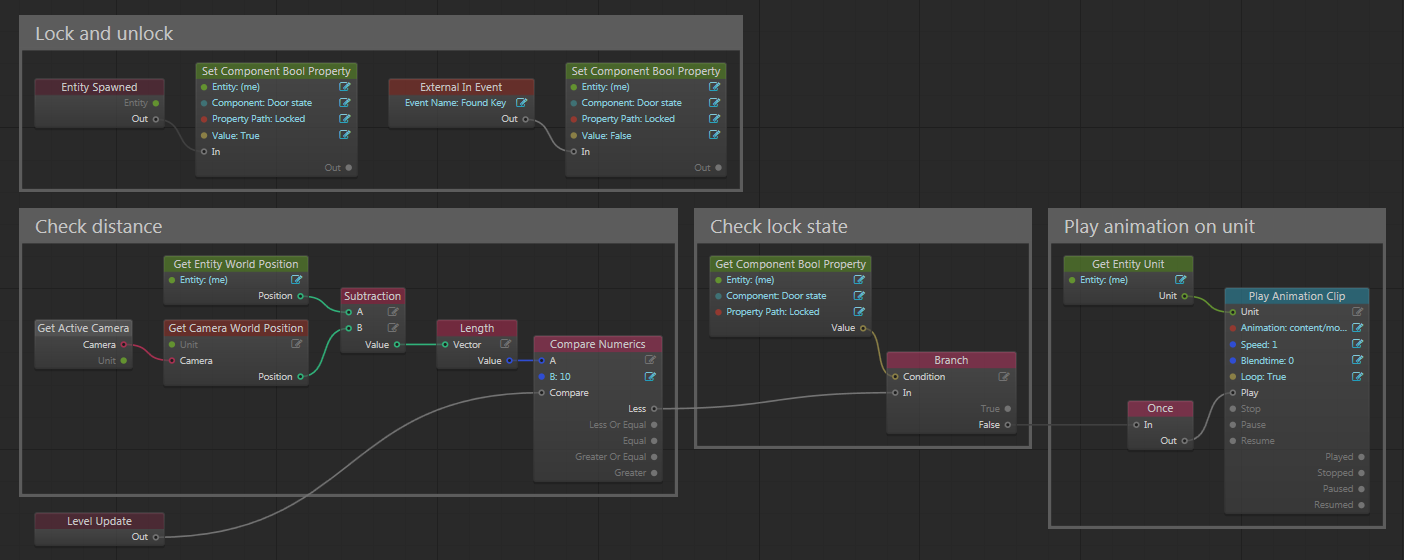

Here's an example of a Flow graph for an entity that represents a door. This door uses a custom data component to keep track of whether or not it is locked. At each frame, if the door is unlocked and the camera is close enough, the door will automatically open by playing an animation on the unit owned by the entity.
This graph demonstrates a few useful things:
how to use Event > Entity Spawned to trigger some logic in respons to the entity that owns this graph being spawned.
how to use the Set Component Property and Get Component Property nodes to set and get data in a data component: in this case, a boolean value that indicates whether or not the door is open.
how to use the Entity > Get Entity World Position node to retrieve the position of the entity from its transform component (if any).
how to refer to the entity instance that owns this graph by using the special My Entity or (me) value in any node's entity variable.
how to use the Entity > Get Entity Unit node to get the unit instance that has been assigned to the entity's unit component (if any).
how the entity's Flow can trigger some logic in response to getting an Event > External In Event. You could trigger this event from a Level Flow graph, or by calling the stingray.FlowComponent.trigger_flow_event() Lua function. For more information on how to access and use that FlowComponent manager in your project's Lua code, see also Interact with entities during gameplay.
