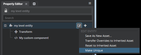

To remove an inherited asset:
When you remove an entity's inherited asset, you make it a unique entity. The entity retains all of its current components and settings, regardless of whether those properties came from the inherited asset or whether they had been set directly on the entity. However, after the change, none of the entity's components and settings are considered to be inherited from anywhere. Changes you make to the old inherited asset will no longer get inherited by the newly unique entity.
Select the entity you want to modify in either the Asset Browser or the Explorer panel.
In the tree view of the Property Editor, click the
icon and choose Make unique from the contextual menu.
Make sure to save the change to the child entity.
