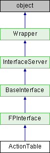

 Inheritance diagram for ActionTable:
 Inheritance diagram for ActionTable:| Public Member Functions | |
