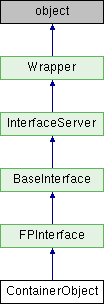

+ Inheritance diagram for ContainerObject:
