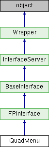

Inheritance diagram for QuadMenu:Public Member Functions | |
