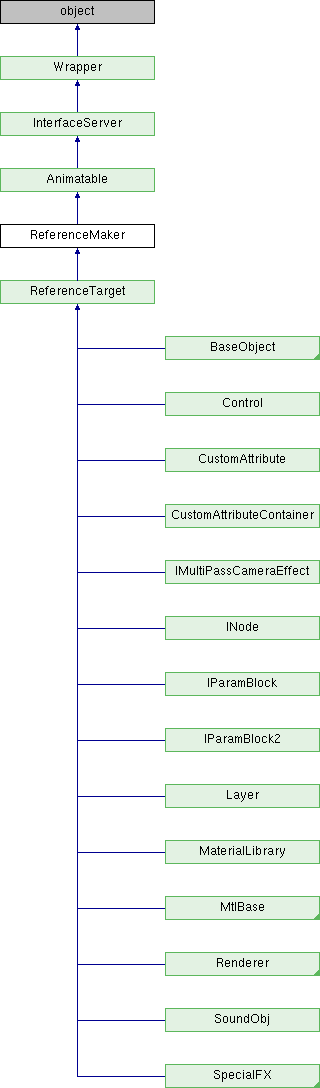

Inheritance diagram for ReferenceMaker:Public Member Functions | |

A scene entity that owns other scene entities and listens to messages from them.
