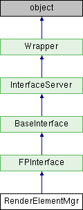

 Inheritance diagram for RenderElementMgr:
 Inheritance diagram for RenderElementMgr:| Public Member Functions | |
