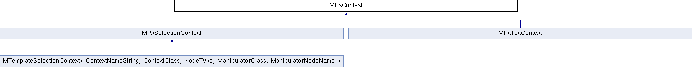

Inheritance diagram for MPxContext:Public Member Functions | |
