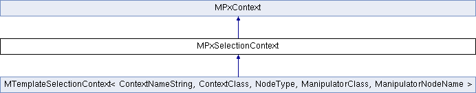

Inheritance diagram for MPxSelectionContext:Public Member Functions | |

Base class for interative selection tools.
This class is used in creating user defined tools that use the internal selection mechanism in maya.
