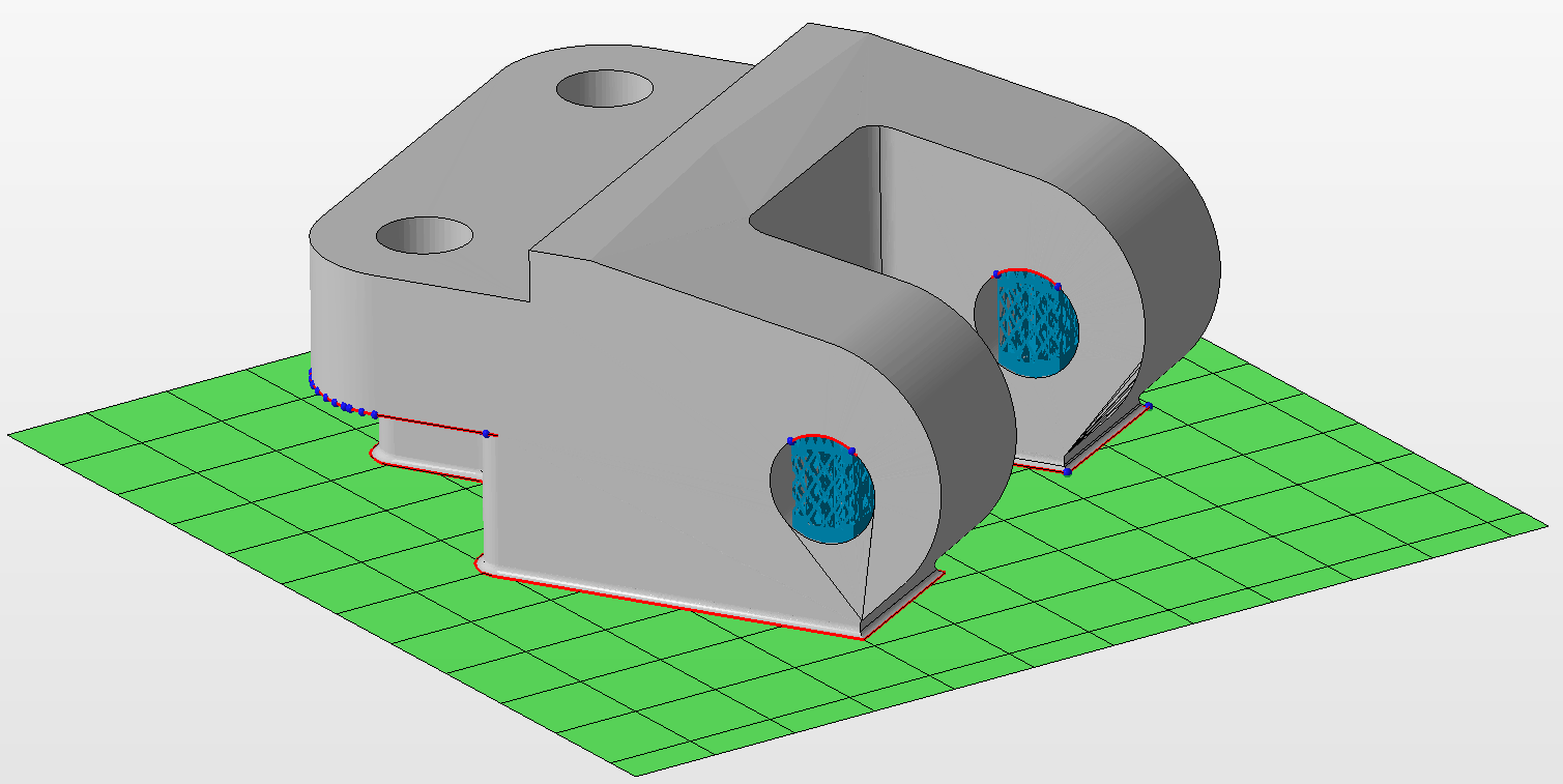

  7. Click Create Supports.
  8. At the bottom of the window, click Run Support Script, in the Choose support script dialog, select SLM, and click Execute.
    The lattice-like supports are created.

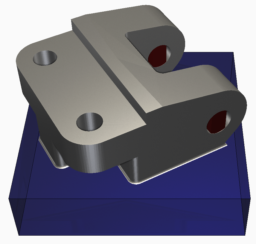

  9. For this exercise, we want only the back supports to be homogenized. Click each of the two curved front supports to select them, then right-click and choose Remove selection. You may need to do this more than once if you see bits of lattice remaining.
  10. Click Apply support.
  11. Click Start build simulation; in the dialog that opens, enter a suitable file path and name, such as Example_21, leaving in place the file extension .3mf. Click Save.
  12. In the Start build simulation dialog, ensure that Postprocess-repair support volumes for simulation is checked, select the Simulation Utility version, if both are available, and click Simulate.
    The exported file takes a minute or so to generate, then opens inside the Simulation Utility window.
  13. If you want to reduce the size of the build plate, click Build Plate > Size tab > Snap to X and Y.

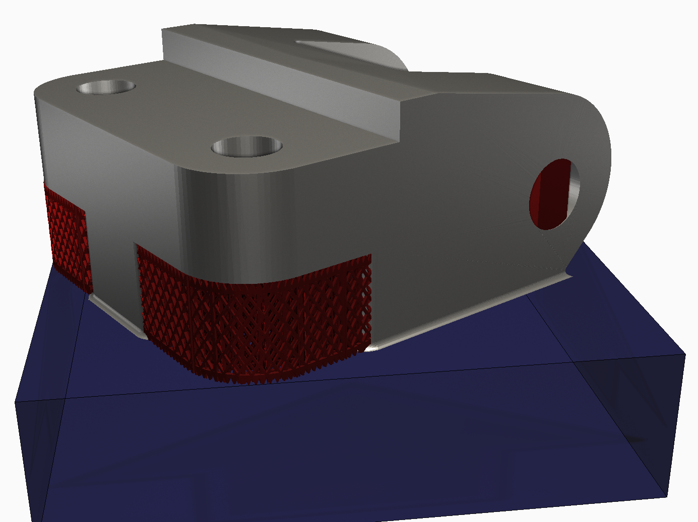

  14. Return to Netfabb to add the lattice type supports. If the Start build simulation dialog is still open, click Cancel to close it.
  15. In the file tree, drag and drop the Example_21 part from the Generic MPBF workspace to the Parts workspace.
  16. In the Supports panel, click Generate Supports .
  17. Click Run Support Script at the bottom of the Support window. Choose SLM type supports from the list and click Execute.
  18. Now delete the back supports which have already been generated and homogenized. Do this by clicking to select them, then right-click and select Remove selection.

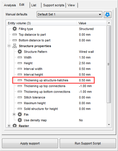

  19. A thickness must be added for the curved front lattice supports to mesh. Select both curved supports by holding down the Ctrl key and clicking the left mouse button.
  20. In the right pane, click the Edit tab.
    Expand the Structure properties menu by pressing the + symbol.
  21. In the Thickening up structure-hatches field, type 0.50. This will create support structure walls approximately 2-3 bead widths wide. Click Apply support.

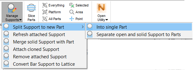

  22. To use in simulation, these supports must be turned into an STL file. Click Manage Supports > Split Support to new Part > Into single Part.
  23. In the project tree, you should see the new part under the Parts node, with (support) in its name. If the part does not appear, right-click Parts > Show Part Numbers.
  24. Right-click the support part and click Export Part > as STL. In the Export Parts dialog, click Select and navigate to the same folder where the first Example_21.3mf file was saved. Name the new file Example21_support.stl, click OK.
