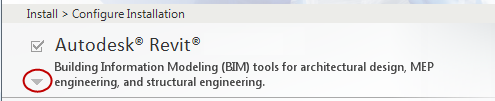

  1. Start the Revit installation program and proceed to the Install > Configure Installation page.
  2. For the Revit software, do the following:
    1. Click the arrow below the product name to expand the configuration settings.
    2. Complete the following items as appropriate:
    3. Click the arrow below the product name again to collapse the configuration settings.
