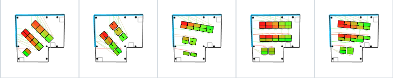

For example, the following image shows Workspace Layout outcomes that try to satisfy opposing goals: maximum desks and maximum outside views.

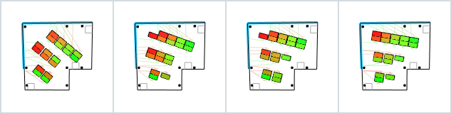

For example, the following example shows how a lack of constraints may result in a workspace layout with only four desks.
