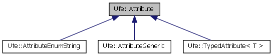

Inheritance diagram for Ufe::Attribute:

Implemented in Ufe::TypedAttribute< T >, Ufe::AttributeEnumString, and Ufe::AttributeGeneric.
