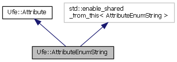

Inheritance diagram for Ufe::AttributeEnumString:
Collaboration diagram for Ufe::AttributeEnumString:
