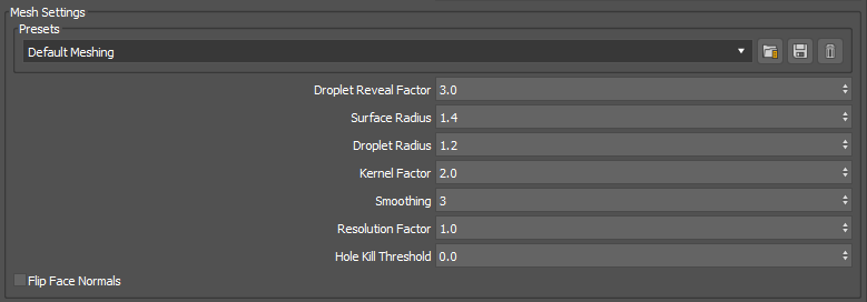

Mesh Settings group
These options only appear when the Display Type is set to Bifrost Dynamic Mesh or Bifrost Cash Mesh.
Presets
Loads, saves, and deletes preset mesh settings. Click to load the currently selected preset from the drop-down list, click to save the current settings, and click to delete the selected preset.
Droplet Reveal Factor
Creates and preserves detail around splashes when generating and smoothing the mesh. Lower values result in smoother meshes, while higher values increases fine, high-frequency detail.
Surface Radius
Sets the radius of each particle blob used to create the surface, in multiples of the base voxel size.
Droplet Radius
Sets the radius of each droplet relative to the base voxel size.
Kernel Factor
Controls the width of the surface smoothing kernel. Smaller values give sharper features and higher curvature in the resulting mesh. Larger values result in smoother features.
Smoothing
Sets the number of smoothing steps performed on the mesh.
Resolution Factor
Sets a scaling factor for adjusting the particle resolution before the mesh is generated. Higher values create more high-frequency detail, but take longer to calculate.
Hole Kill Threshold
When increased, eliminates meshed holes in the interior of the fluid. Such holes can occur especially when using high Resolution Factor values with spatially adaptive simulations.
Flip Face Normals
Inverts the normals of the surface.
