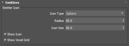

Emitters rollout
Use the Emitters rollout to set emitter options for the selected solver. You can also set or change these options in the Create/Modify panel window.
Emitter Icon group
Icon Type
Select the icon type for the emitter: either Sphere, Box, Plane or Custom.
Sphere
- Radius
- Sets the radius of the sphere emitter.
Box
- Length
- Sets the length of the box emitter.
- Width
- Sets the width of the box emitter.
- Height
- Sets the height of the box emitter.
Plane
- Length
- Sets the length of the plane emitter.
- Width
- Sets the width of the plane emitter.
Custom
- Add Custom Emitter Objects list
- Adds a custom object as the emitter. Click Pick to select an object from the scene, or Add to choose from a list. Click the Delete icon to delete an already added custom emitter.
- Icon Size
- Set the size of the fluid icon.
- Show Icon
- Shows the Fluid icon in the viewport.
- Show Voxel Grid
- Shows the Voxel Grid to visualize the current base voxel size.

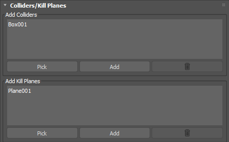

Collider/Kill Planes rollout
- Add Colliders list
- Click Pick to pick objects from the scene to add as colliders, or click Add to select colliders from a dialog. Click Delete to delete an existing selected collider.
- Add Kill Planes list
- Click Pick to pick objects from the scene to add as kill planes, or click Add to select kill planes from a dialog. Click Delete to delete an existing selected kill plane.

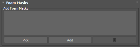

Foam Masks rollout
- Add Foam Masks list
- Click Pick to pick objects from the scene to add as foam masks, or click Add to select a foam mask from a dialog. Click Delete to delete an existing selected foam mask.

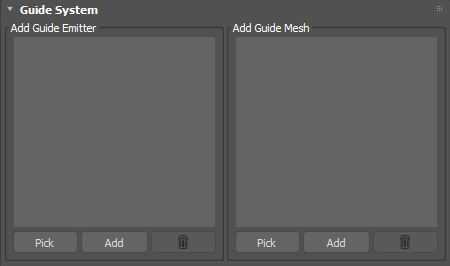

Guide System rollout
The Guide System requires a mesh as a guide emitter and a mesh to guide the liquid. It does not use the standard emitter but will use collision objects.
- Add Guide Emitter list
- Click Pick to pick objects from the scene to add as a guide emitter, or click Add to select a guide emitter from a dialog. Click Delete to delete an existing selected guide emitter.
- Add Guide Mesh list
- Click Pick to pick objects from the scene to add as a guide mesh, or click Add to select a guide mesh from a dialog. Click Delete to delete an existing selected guide mesh.

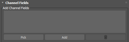

Channel Fields rollout
- Add Channel Fields list
- Click Pick to pick objects from the scene to add as a channel field, or click Add to select a channel field from a dialog. Click Delete to delete an existing selected channel field.

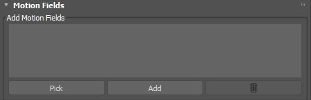

Motion Fields rollout
- Add Motion Fields list
- Click Pick to pick objects from the scene to add as a motion field, or click Add to select a motion field from a dialog. Click Delete to delete an existing selected motion field.
