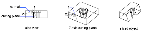

Z axis
Defines the cutting plane by specifying a point on the plane and another point on the Z axis (normal) of the plane.
  • Specify a point on the section plane. Sets a point on the slicing plane.
  • Specify a point on the Z-axis (normal) of the plane. Specifies a point that defines the axis that is perpendicular to the slicing plane.
