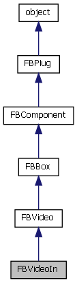

Basic video input class, supporting webcam and DV device. More...
