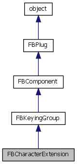

Objects Grouping class. More...
This class is an interface to manipulate object's grouping in the scene.
