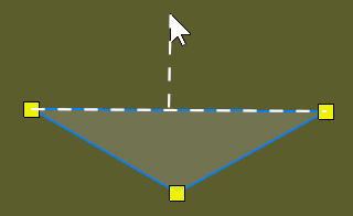

New points are always added above the perpendicularly nearest edge regardless of the order in which corner points were placed.

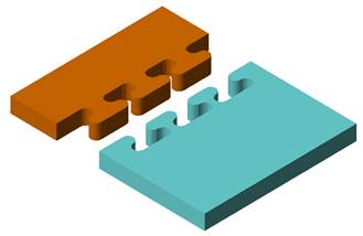

The edges of polygon cuts can be configured to create dovetail, jagged, or puzzle-shaped edges.
To configure
only specific edges, right-click the edge and choose
Edit Edge
A cut with puzzle pins
