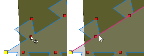

Create polyline Create the cutting stencil as arbitrary polygonal line by successively adding more points.
Create circle Create the stencil as a circle with a centerpoint and a radius.
Create rectangle Create the stencil as a rectangle with a centerpoint, a width, a height, and a rotational angle.
Edit edge Opens the dialog to define matching features on all polygon edges for joining parts. Only available for arbitrary polygons
Select and position parts Temporarily fixes the stencil and lets you move the part against the stencil
Reset perspective to cutting direction Changes perspective to look perpendicularly onto the cutting stencil
Reset polygon Clears all stencils

Polygon cut
Load/Save
Top
Polygon edge configuration
Mouse controls for edge feature configuration
