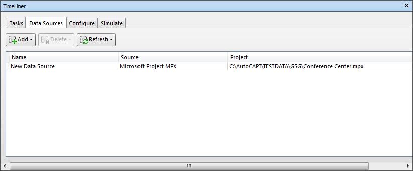

The Data Source View
The data sources are shown in a multi-column table. The columns show name, source (for example, Microsoft Project) and project (e.g. my_schedule.mpp). Any further columns (there may be none) identify the fields from the external schedule which specify the task type, unique id, start date and end date for each imported task.
You can move and resize columns, if necessary.
